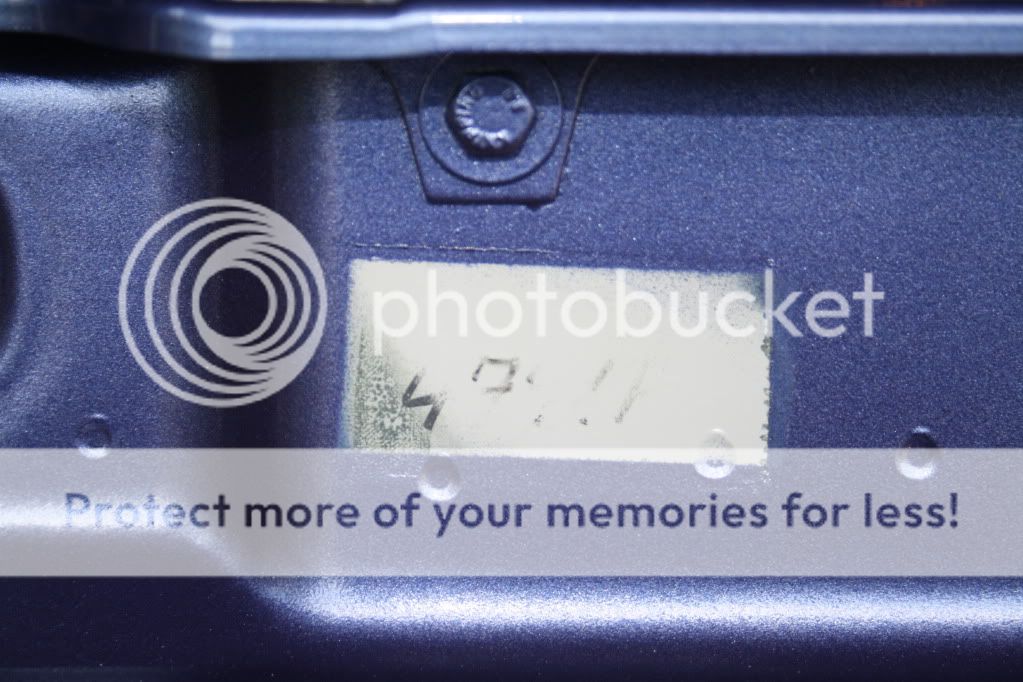

Ithink this image shows the offending area , with the shield and the plate showing...

Right then, are you ready for this... :eek: :eek: :eek: :eek: :eek:
Spent the last hour dismantling (ignore the exhaust paste on the silencer - I have a replacement silencer going on after this job)...
The aluminium heat shield did have a fare bit of crud behind it, but the chassis it was touching was ok. However the bumper support to chassis is clearly the issue here. But don't PANIC it's not a massive repair job and it's well out of the way cosmetically. I will get on with this now and provide photos as I go. The PU will have to come off, but then it's all quite accessible. I will probably repair the bumper supports with new metal as it's a pretty simple piece.
