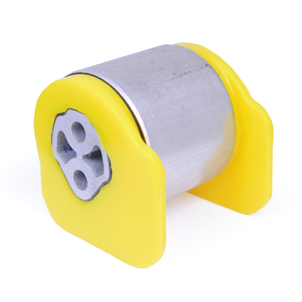

Mine have just arrived and there is a wider flange than I’d thought (been there before!) should I trim it down a bit more?

Powerflex did a product recall on them. If you contact them, they'll do a free swap for the new style.
NVH - https://en.m.wikipedia.org/wiki/Noise,_vibration,_and_harshness
I only ordeded them from PF on Monday so I hope they're the revised ones? Part number is PFR57-530-AA.
Should look like this:
